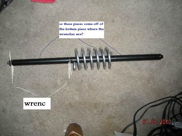

how do i take apart the 10k??? doesnt the bottem shaft unscrew from the top coils? i have a 9inch shaft

Yes it does.
All I did was hold them real tight and unscrew.
If its to hard and slippery use something rubber to wrap around did that also. :oops:

what parts come apart? i have the single coil 9inch shaft

i painted mine but this morning i just tried to crecent wrenches on the two hex parts and it wont come apart here is a pic maby u can point to what parts come apart and how.....Image

unless im mistaken you have 3 parts there, bottom shaft, coils, and top shaft. mine comes apart with cresent wrenches and elbox grease

iv twist and tuned no such luck...wtf

yup i think i heard someone use a strap wrench on them too

ok so i need a FIRM grip on the top part where the whip connects to. than put a wrench on the bottem end where the screws in and TWIST? and the top half shuld inscrew and i shuld hhave a bottem half and a top half now the top half will be the coils and the rest of the top part? maby i need to take the paint off real quick and maby thats why its not comming apart cause i did use some strong asss paint bumper and trim paint

the paint may be causing it im not sure what is used when they are produced but its not just hand tight lol

the hex parts on the lower shaft are both on the same shaft that's why they arent moving.
Take your crecent wrench and a pait of channel locks, use a rag on the channel lock, aluminum mars easy.
Grab above the top hex. crecent on the hex.
yes there are 3 parts...

thanks mojo. oh when i unscrew it will the bottem piece have 3/4 thread inside? btw take a look here please. viewtopic.php?f=5&t=31994" onclick="window.open(this.href);return false;

Your doing it wrong! If all you want to do, is take off the lower shaft, put your wrench on the top hex nut right under the coil...Then take a pair of vice-grips and stick them between the turns of the coil, and clamp down on the insulator, then turn counter clock-wise and the lower shaft will unscrew off...
Note: Before you clamp down on the insulator, put a old rag or piece of rubber around the insulator to keep the teeth of the vice-grips from digging into the insulator!
There is actually 3 pieces used to make the lower shaft! and the top shaft as well...And that's not counting the set-screws, and studs...The coil is made up of a insulator, coil, 2 set screws, and studs...Allot of time is taken to put these things together. The lower shaft, and top shaft look to be only one piece, but trust me, it's not! After the shafts are all assembled, Kale puts the parts on a machine that brushes the aluminum so that you can't see the seams where the parts are screwed together.
If you want to see a what it would look like, if he didn't brush the parts, just look at the 10K Clone that Tram builds...It has all the same parts as a 10K, but not brushed out...(it also "WILL NOT COME APART!...so don't try, unless you want to buy another antenna!)

gee i didnt know mojo had a website both sites are bookmarked. ok i got it apart. right on it was very simple what is that nasty brown gewy **Censored** on the threads inside?

Interesting. So, can you add 2 shafts together. In other words, to they come apart to the point that they are compatable thread wise and can be mated? I've got a trashed 9 inch shaft I'd like to mate to a 12 inch one. Can this be done with existing parts? Or, is there a common hardware store piece of althread/allen bolt that will make it possible that anyone knows of?

No the threads on the top of the bottem shaft are huge LOL too bad or id be using it on my 102 for swrs ull have to buy a new shaft just like im gunna do im gunna add a 12 inch and cut the whip down.

You can do what your talking about, if you have several 10K's to use as parts, and the spacer that is used on the dual coils......I know I was fooling around with some of my 10K parts, and used a shaft, and top section together once to build a taller top section...What I was doing was trying to make a version of Kales Fighting stick 10K, without having to use a stinger...Didn't work out tho...even using a 27" lower shaft on top, I was still too short...
The threads on the parts are just standard threads...nothing special, But I have no idea where you would find aluminum parts to screw the sections of shafts together, unless you go threw Kale.
If what you want is a longer lower shaft than the 27", I would just call Kale and he will build you whatever length you want...I know one guy that had Kale build a 48" shaft!

Post by Fast4socal » Saturday, 09 January 2010, 17:33 PM
all right my 10k is a 9inc shaft with a long gluteus maxims stinger i wanna add a 27" shaft how much of the stinger would i need to cut?

Post by jessejamesdallas » Saturday, 09 January 2010, 17:51 PM
Fast4socal wrote:all right my 10k is a 9inc shaft with a long **Censored** stinger i wanna add a 27" shaft how much of the stinger would i need to cut?
Your going to need to be using a SWR Meter to figure that out "exactly"....Could be as much as a foot or more. Don't just go and cut off a foot to start with tho...Check your swr when you get the 27" shaft on, and go from there cutting off maybe a inch at a time...If this is a regular single coil 10K antenna, regardless of which shaft you have, the total height of the antenna should be somewhere around 7'...

MoJo wrote:The gooey brown stuff I believe is locktite...
It's a grease similar to what is used in amps when installing the transistors. Kale dose not use the gray stuff anymore tho, and now uses a white grease. It's there to help keep the water out...
If it was locktite, there would be no-way to take the thing apart! And that might be what Tram uses on their 10K Clone, because that puppy "Won't" come apart! :mrgreen:

Top part you will need two pairs of vice grips to remove, since there is no hex nut to put a wrench on...Just clamp your vice grips to the top section, and the other to the insulator, then turn counter-clockwise...
And like you did before, put something between the vice grips and what your clamping down on, so the teeth don't dig into the antenna...
